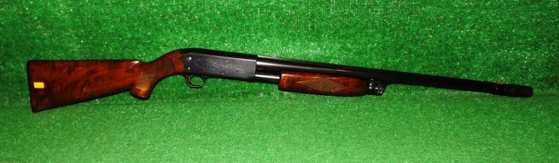

I wouldn't consider myself a "collector" of 37's (this brings my total up to 4 currently), but I definitely appreciate them and hold them in the highest esteem for a pump gun. For the last 3 years I've been searching for a nice 37R and finally found one that fit everything I wanted (a solid rib) and exceeded my wood expectations.
In "very good" condition with a 26" Poly-Choke barrel (which I can't give enough props to as a practical field device even though many find them ugly).
I impatiently waited and waited for the parcel to arrive. 9 days after the scheduled delivery, I finally had confirmation it had arrived! I came home from work to see the box leaning against the couch and I tried to restrain myself from just ripping the box apart.
However, disaster struck as soon as I took the bubble wrap off the stock...
In my opinion this damage wasn't caused by shipping and my best guess is it was dropped after being wrapped in the bubble wrap but before being put in the box. It's obviously a recent crack as there's no evidence of any oil or dirt in the crack and the broken piece was sitting so tightly against the stock and didn't fall off until I turned the gun, that's my best guess. I really have nothing to base this on however.
I'm still in disbelief that I opened the parcel to that. However, I'm currently looking for a good wood man to get it back into shooting shape.

If you go back and look at the post about a 16ga parts gun, you can see the stock that I glued back together for my friend. I used a good grade of wood rated superglue. It dries slower than plain old super glue and will give you time to put it back together if you decide to keep the gun.
The superglue is thin and as long as you practice going through seating the broken pieces a couple times before you glue (to get it into your head what you are doing) you should be able to fix it yourself for a couple bucks.

Ooooh. Man, I feel your pain. Was it insured during shipping? If you bought it from a reputable seller/dealer they should work with you. Hope it all works out. I see the small yellow tag on the stock. Was this gun bought at auction?
Let me guess--the gun was shipped assembled as the one below was shipped to me. If so, the barrel acts as a lever and puts stress on the wrist--through pin be damned.
I nixed this deal. My LGS called me, I took the photo and the lgs shipped it back. I got a full refund. Never, ever ship a gun with barrel assembled if it can be taken down.

Holy cow, it's like a mirror image of mine. You're right, it was shipped assembled (why they did is beyond me...). I guess that explains it.

That happened to me over six years ago. Since then, when buying long guns from out of state, I send the photo to the seller and ask them to be sure and disassemble. My local gun shop tells the story of an 870 shipped assembled and the through bolt was bent before the stock broke. Never underestimate the skill of a shipper to wreck a gun. Gil

I had this happen to me about 5 years ago from a Gunbroker seller in Michigan. It was a 1948 16 gauge. It travelled only 200 miles to my dealer in Western New York State. Same thing, it shipped fully assembled. The stock had a small 1/8" x 1-1/4" chunk right behind the receiver crack out, but it was NOT found in the packaging. I assume some dullard did it before it shipped as no stock pics showed it in the listing. I worked with the seller to remedy, but he gave the runaround. I finally gave bad feedback on GB and he no longer sells there. It cost me more than the gun did to repair it.

Cory, there are folks that can repair the stock without leaving a trace of repairs. Mark Larson has repaired 3 stocks on double guns of mine one of which was shattered at the wrist and there is no trace of repair. Mark is in Tacoma, Washington, and is fast and reasonable. Canada to US complicates matters unless the stock can be repaired without the receiver being sent. www.marklarsongunart.com
Clean break, easy fix. I would use Brownells Accuglass, clean up later with a razor blade, fine sand paper, 0000 steel wool. Then stain and use minwax spray laquer. If you do it like I did, the crack will not show.
