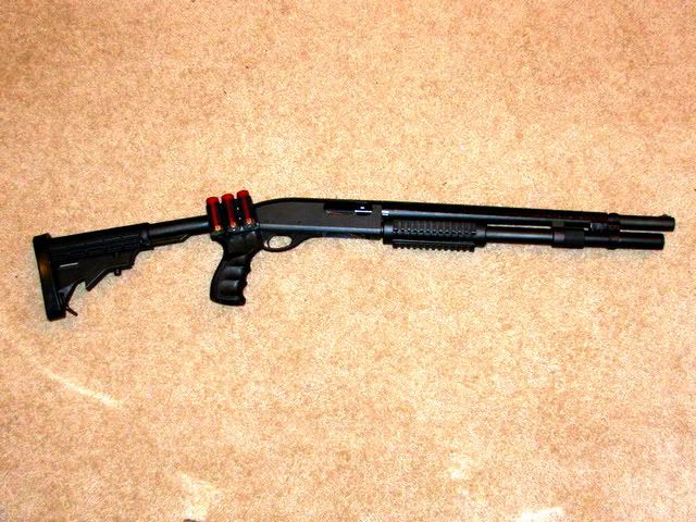

This is the gun I drilled out the dimples on.
2004 870 Express 12-GA. 18" w/Tac-star 2 shot. Speed feed police forend and new style Remington butt stock.
As for procedure, start with a small (sharp) drill bit and work your way up to about .187 (3/16"), and don't try to drill through both sides at once.
Otherwise the only thing I would add to my previous post above is to strip down the gun entirely including removal of the trigger group. (so as to not get any chips in it) Then clean it / blow it out best you can after drilling, re-lube and assemble. Otherwise see above.
Note, on the drilled pictures. the four points you see were left over from the embossed dimples. I saw no reason to drill any larger than necessary.

thanks man, this helps. All my other 870s were pre-dimples.
Sorry for not getting photos. Mine look exactly like those posted previously.
Very helpful indeed. Thanks for posting the pics
Be well and Mors Ab Alto!
Rhino Sends
