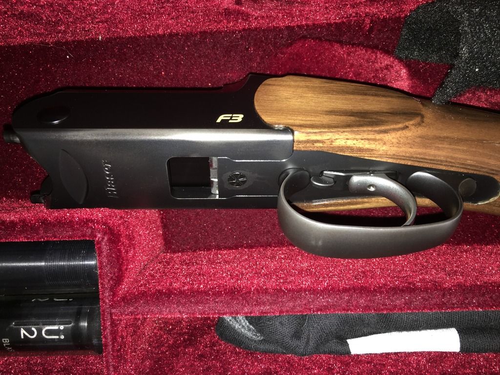

Wondering if any of you fellow F3 SuperSport owners have had any finish wear issues, and if so whether Blaser has warrantied it? Mine has slight finish wear on the bottom of the receiver and trigger guard, making it a grayish silver color instead of black. My gun is only a couple years old and has maybe 2k rounds through it, so I'm hoping Blaser will warranty it and re-coat the receiver, but just wanted to see what you guys have experienced. Aside from this minor issue, I love the gun. Thanks.

I can provide an update to this topic. I have a Blaser F3 that is a few years old. It has some wear on the receiver. I took it by the Blaser trailer at the U.S. Open last week. They said I should send it to them in the off season, leave it with them for about a month, and they could repair it for $250.

To those who need a finish that needs no maintenance, rust proof, will last for a really long,long time and is also very appealing, Cerakote finishes espesialy in different rich blacks to choose and you can ask to be made match the original are superb in my opinion. Ask for real demo jobs to see with Cerakote and if its done right they show not at all cheap and you will be more than happy. Do not reject this option at once for the gun status thinking it not appropriate for a Blaser, first see, search and then deside. Propably will do it just once for the rest of the life of the gun.
A sample of a Blaser with Cerakote. The gun is far better in real, like factory job.
