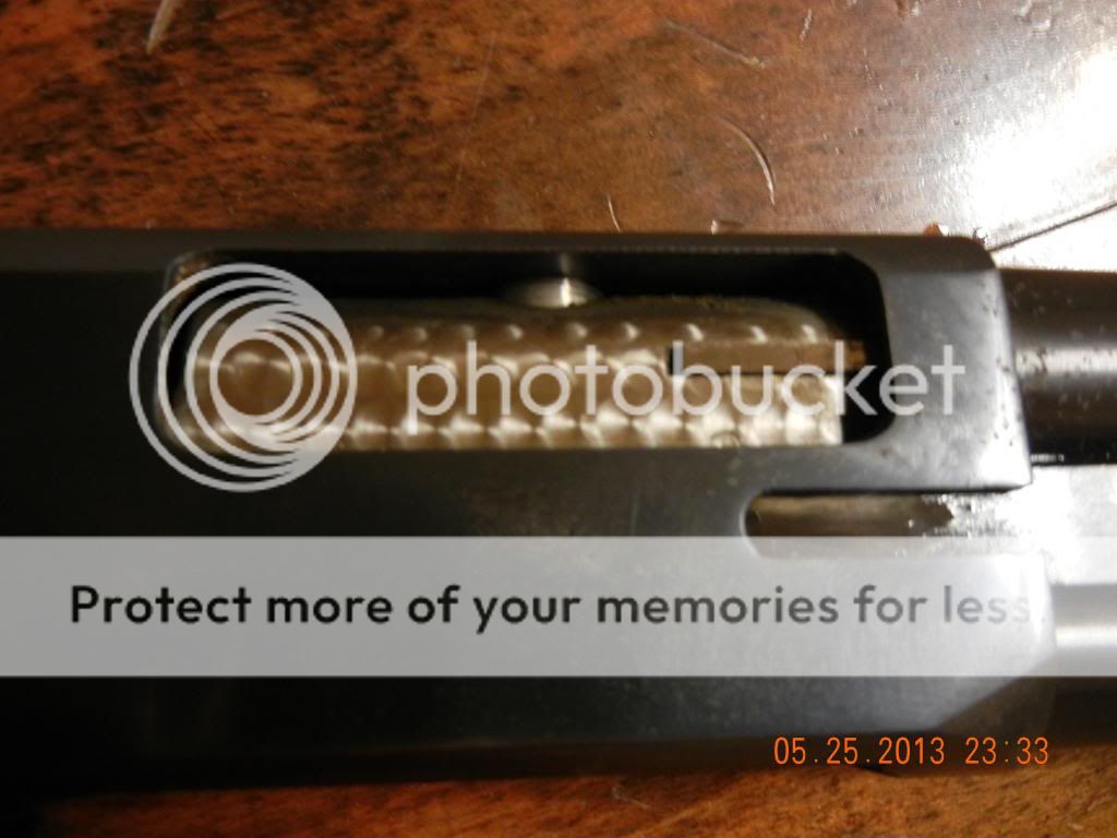

The 20 gauge has the most unusual locking system I've ever seen on a pump shotgun. That locking bolt is perfectly round, and fits up in the top of the action like a bolt in a dead bolt door lock. It's not nearly so smooth on the 20 gauge to work as it is on the 12:

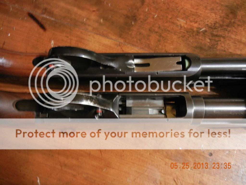

Now for a view from the bottom of the guns, the 20 being the gun on top. The 12 gauge looks like you are looking up inside an extremely well made Mossberg 500. The shell follower is steel. There is no stamped shell lifter. There is more machining. The 20 gauge has the appearance of a cheap, stamped out economy shotgun in comparison, with a cheapie stamped shell lifter and a green plastic shell follower. What you can't see is that the 12 is the smoothest pumping shotgun I own and the 20 is the hardest to pump of any pump shotgun I've ever owned or borrowed. The 20 will work, it's not gritty or rough, but it requires lots of effort. The hard pumping doesn't interfere with actual use,,,but be forewarned if you buy a 20 gauge High Standard pump that you must use effort to pump the gun.
