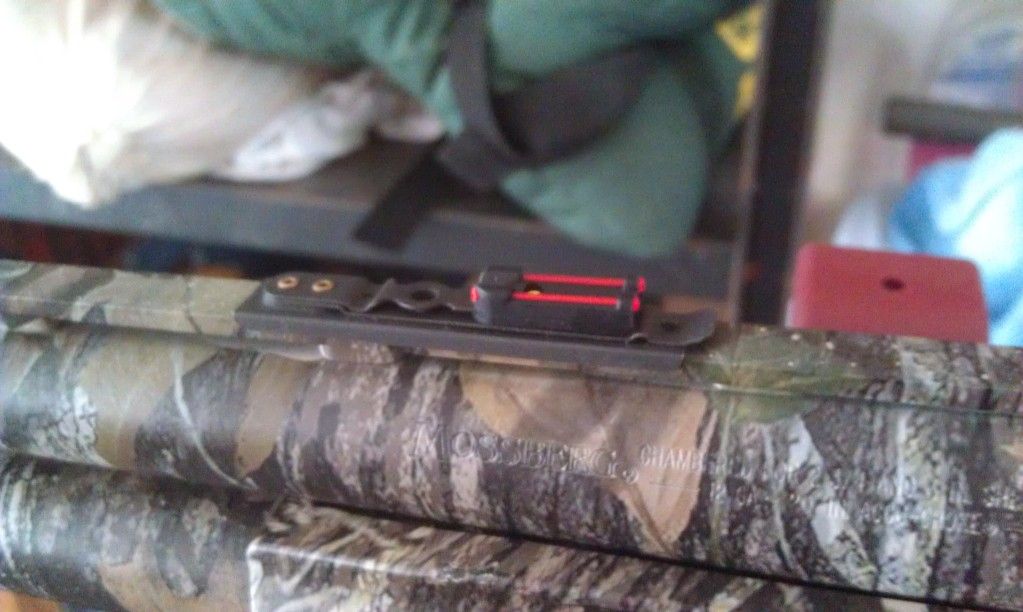

I have a new 500 12 ga. with a 20" barrel and factory "turkey sights". The gun will be my buckshot deer hunting gun. I patterned it today at 30 yds. and with sights adjusted as far down as they go it still shoots high with any type of round I used. Now I'm not a big fan of these type sights so I may not keep them on but I'm trying to think of a way to correct the problem. If I was to go to a standard tru glo type front sight only would it need to be low profile or high since its shooting high?

These are snap on type sights so I don't see any way to move them farther. The front is fixed and the rear I removed the elevation screw to get it as far down as possible. So I'm thinking I'll look at just getting a front bead or tru glo wing shooting type sight.

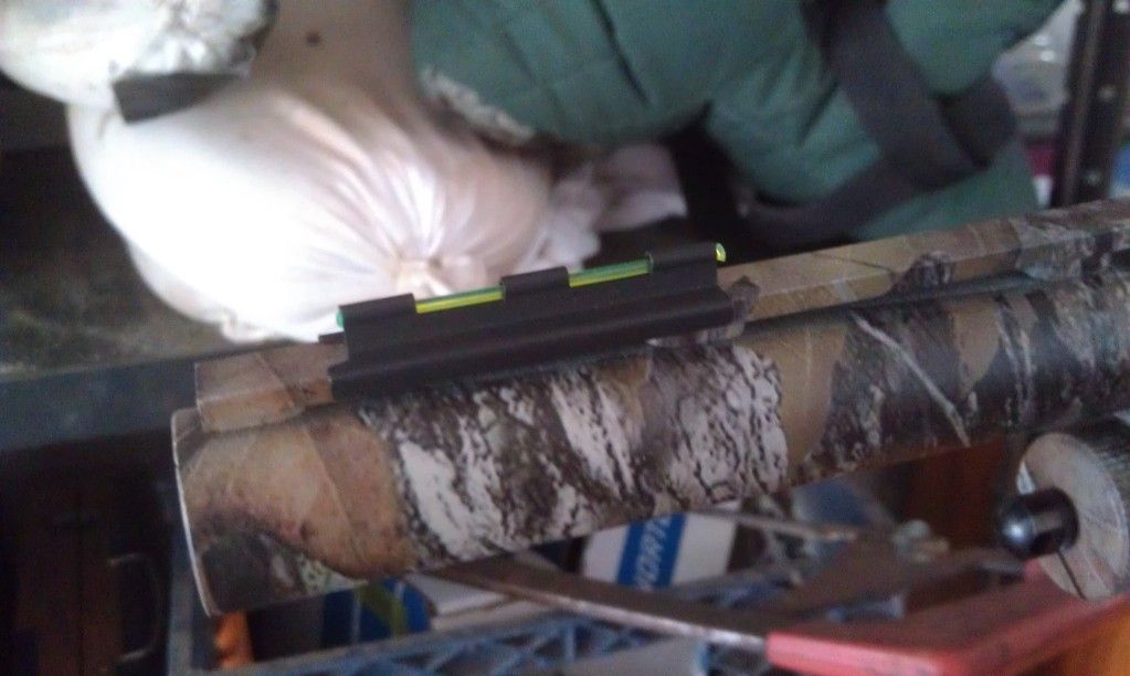

I have now corrected the problem by adding about 1/16" height to the front sight, I'm not using a rear sight just a fiber (bead) on front.
