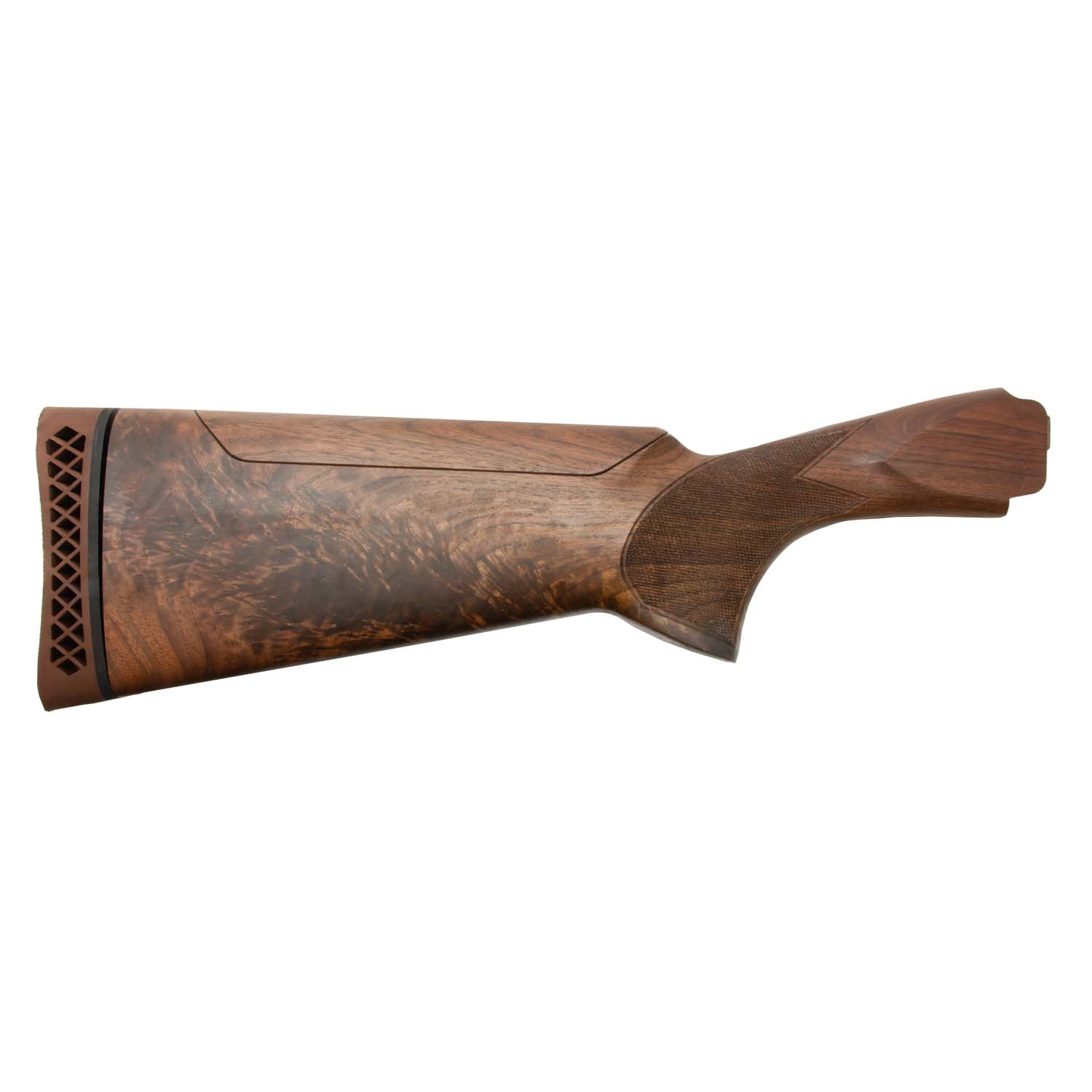

I have a Citori XT Trap which I love shooting but the butt stock has a crack at the base of the tang. I tried MGW for a replacement stock, but they were all out. Macon has a stock for a 425. My question is will a 425 stock fit and XT action? It is the short tang version. Thanks in advance. Any help will be appreciated.
I asked a skilled local gunsmith, who's work on other guns for both my wife and me, and he told me he couldn't repair the crack. It's still functional the way it is now, but I'm afraid it'll separate in the middle of a club match. Maybe I'll just try to find someone who specializes on stock repairs. Good advice, thank you!
Your XT has a high and possibly parallel comb specifically built for Trap shooting. Stocks are not necessarily interchangeable on most O/U, but often can be fitted with a little tinkering, for lack of a better word. As far as I know, a 425 stock will be a field stock with completely different dimensions from the trap stock on your gun. Are you aware of that?
