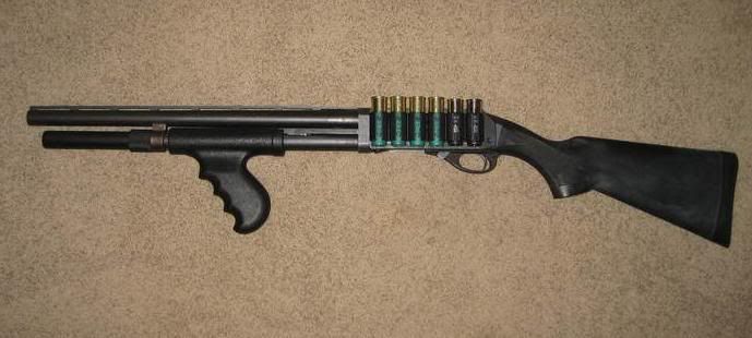

You could always just buy a short chunk of rail and bolt it to your current forend.
http://www.midwayusa.com/viewproduct/?p ... mpaign=649
I really like my TacStar, they are cheap as hell but feel pretty good.
