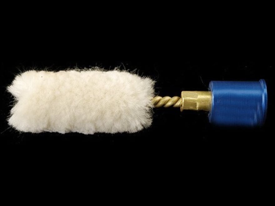

I prefer to store my guns with the hammers relaxed. the best way to do this is by using snap caps.
these are the style I like:
do not buy the plastic ones, they will break after a period of time. good luck & good shooting with your SxS (y)
