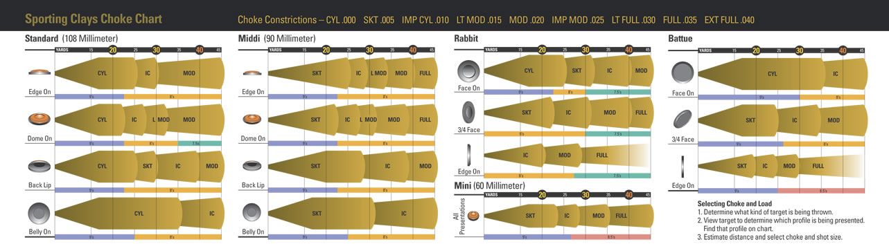

i am a new member of this board, and i had one question that i would really like to get the answer of. i was wonderin how much the pellets spread out, out of each type of choke. at what distance. if anyone knows the answer or knows where i can get more info on this. ur help would be appreciated. because im lookin into buying a shotgun for self defense, and i was wonderin which type is the best, for self defensse, as in spreading wise, as it will be more affective

Well, I couldn't tell you how much a certian choke spreads at certain ranges because each choke shoots differently.
For a rough idea, a cylinder choke spreads the most, as it is no choke at all, it is used for bird hunting at VERY close range, and for slugs. A skeet or Improved cylinder choke is open as well, but it will give you more effective range. (about 20-30 yds) and a modified (30-40 yds) and full(35+)

Rough rule of thumb for shotguns: pattern diameter increases by about 1" for every added yard from the muzzle. So the pattern at 5 yds = 5" and 10 yds = 10" (which you can verify by shooting your gun at a peice of cardboard at these distances). Not exact, but close enough. Given the application is home defense, recommend taking a course, such as those offered by Massad Ayoob at his Lethal Force Institute http://www.ayoob.com/ or at least getting some of his books and giving them careful study. The book, "Armed Rsponse - A Comprehensive Guide to Using Firearms for Delf-Defense" by David Kenik is also excellent.
Normally spread is. Full choke is 2 1/2 feet at 30 yds. Modified is 3 feet. Improved cylinder is 4 feet. All guages. The Sporting Shotgun by ROBIN MARSHALL-BALL.
