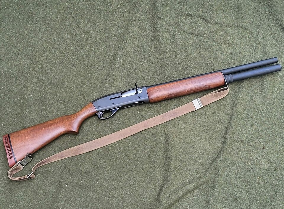

Here’s my 11-87 with my second Turknelli M4 out zeroing in slugs a couple months back.
