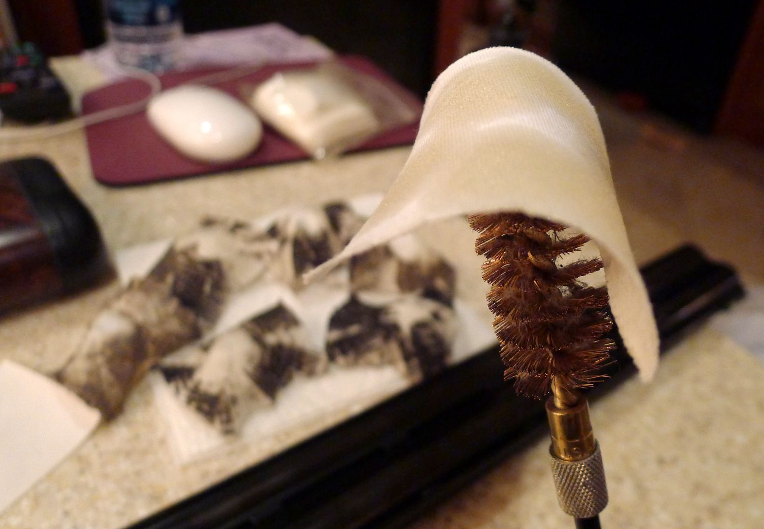

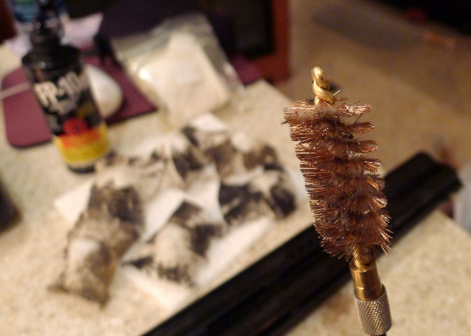

A 12 ga. copper bore brush serves perfect double duty as both a scrubber AND as a jag to hold cotton patches.
If the chamber or bore should need some scrubbing, apply shotgun cleaner to the copper brush itself - no patch - work out as needed.
THEN...
Lay a 12 ga. cotton patch over the brush, spray it with shotgun cleaner, and run through the bore (or bores).
Works just great! Always a perfect, and snug, fit.
Spray a little more shotgun cleaner on another patch... run it. Repeat as needed.
Follow with a fresh, dry patch, as needed.
Finish with a patch with some FP-10 applied, run it. Bore is ready for short or long term storage.
The brush holds the patches quite securely while running up and back through the bore.
