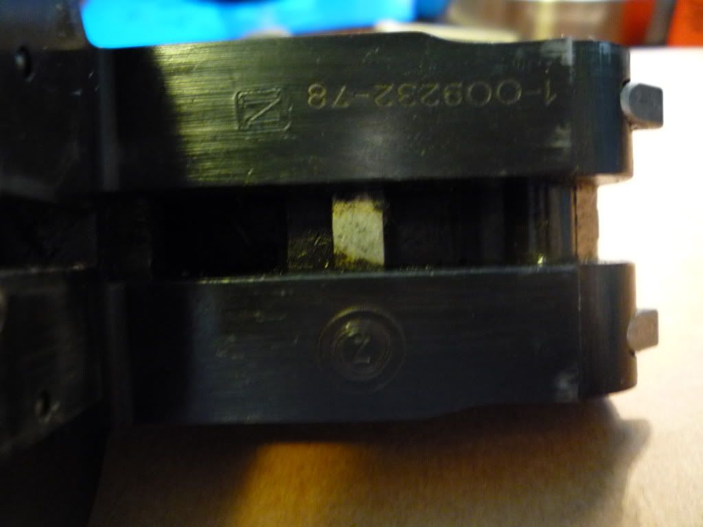

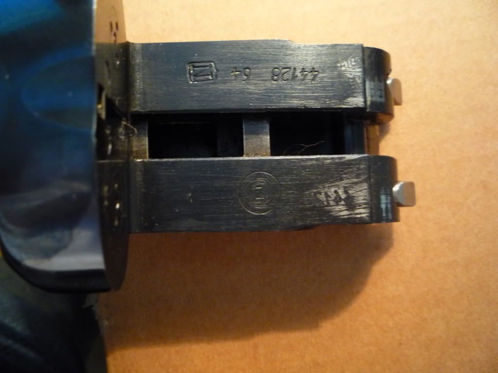

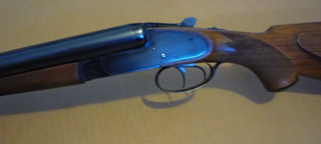

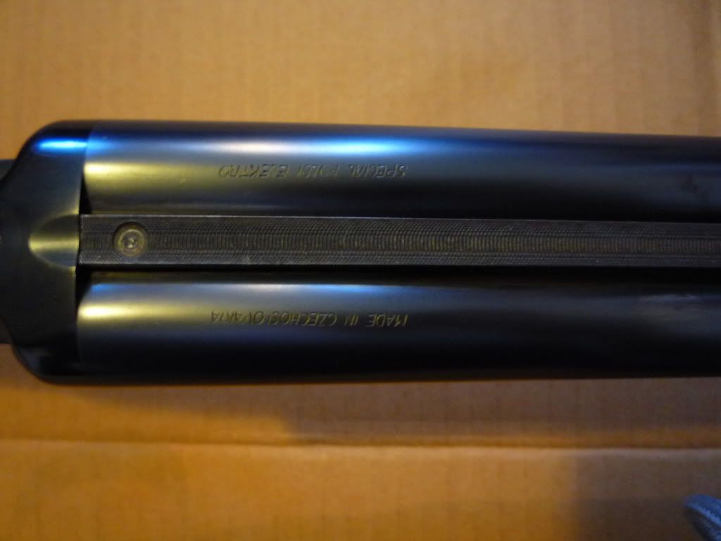

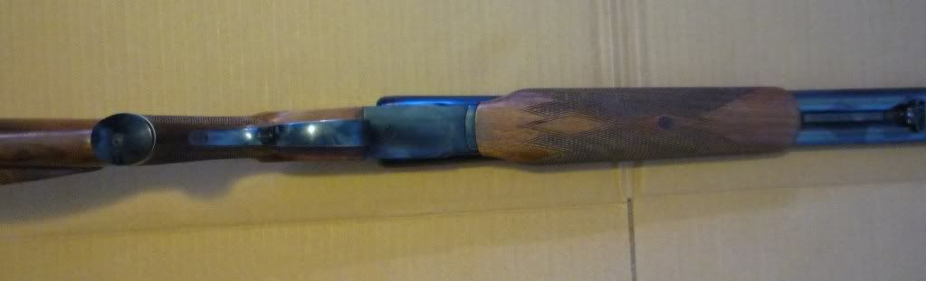

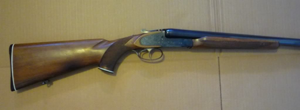

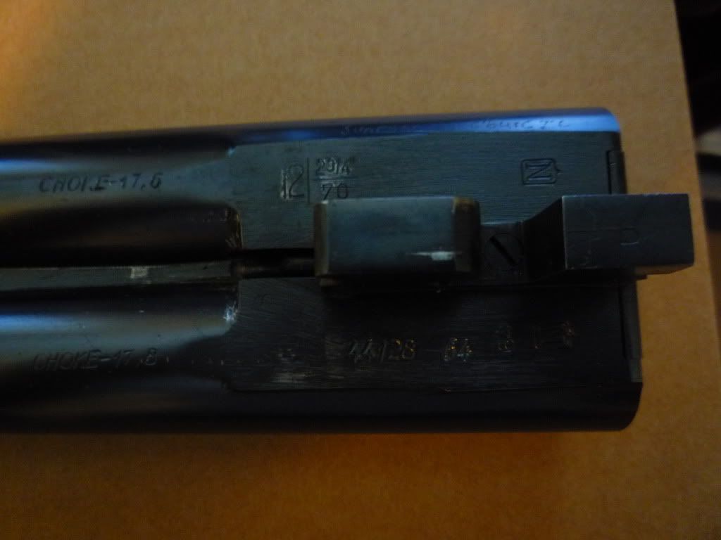

Once again I need help. I picked up two more SxS shotguns today These two are made by CZ. They look VERY similar to each other, one has some "stamped"? engraving, while the other one has "plain" sides. Both are sidelocks and have double triggers and the barrels are marked "Special Poldi Elektro., Made in Czechoslovakia". Here are some photos. Any information about this will be greatly appreciated (Quality, value, negatives, etc). Thank you very much.

I see a 78 and a 64 on the water tables, are these the date of manufacture?
They appear to be BRNO "ZP" model double shotguns; the numbers are the date codes.

During the early 1970's the Brno ZH (O/U) and ZP (SxS) series were imported into the States by Dan Wesson. The ZP series was catalogued by Frankonia Jagd until the early 2000's and enjoyed a strong following in the European market.
FWIW, the ZP series were surprisingly well built for the money. The 1985 price was DM725,- or about US$253.-. That bought a genuine sidelock action SxS powered by coil springs, double triggers, chopper lump barrels with double underlocking lugs and a hidden third fastener. The top lever also has a coil spring. The sidelocks, however, lack an intercepting safety sear. While the Brno catalogue lists the right barrel as being 1/2 choked and the left barrel as 3/4 choked, it also claims an "average coverage of 60 - 70%" at 35 meters with No. 3 shot (3.5mm dia.) which is closer to modified and full. I've found no mention of other choke choices.

Thank you all very much for your assistance. I am an avid gun collector, but until 2 weeks ago never owned a shotgun (Or knew much about them). I finally took the time to look at one carefully, and fell in love with side by sides. 2 weeks later, I own 4 of them.
Based on your description, I am fairly sure that the two CZs I have are: ZP47 models. I still have not been able to find a value reference for them. Any ideas?

Thank you very much. I guess that I had convinced myself that what I had where ZP49s or 149s (The only ones I found on the Blue Book of Gun Values) that I completely missed the fact that you had included the ZP47 model in your posting.
My plan is to keep only one and trade the other one and since they are both in similar condition wanted to find out which one will be more desirable. After reading some of the comments, I might end up keeping both. Thanks again.
