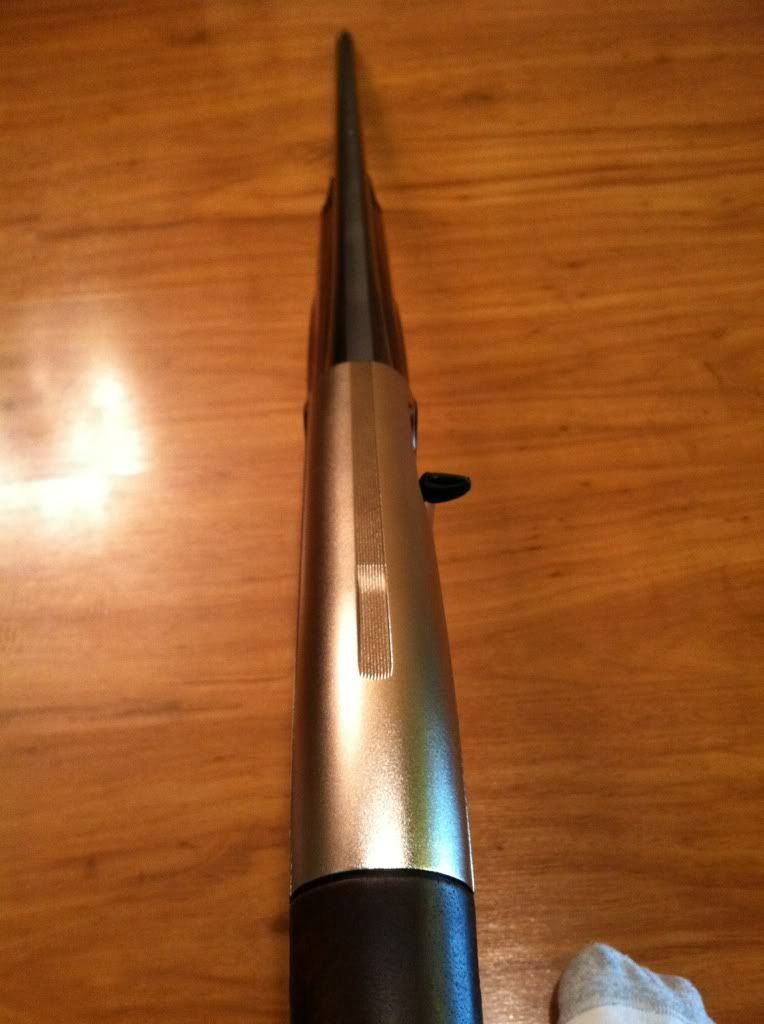

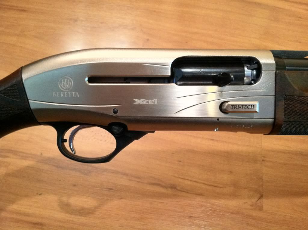

The steel magazine tube was also electroless nickeled. The internals of the receiver are also nickeled. IT ACTUALLY CYCLES SMOOOOOOOTHER. I don't feel the "clink ching" anymore. There is no noticeable glare off the top of the receiver either.
Hope you all enjoyed it. Blue ain't the end of the world! I can't even believe this is the same dull and ugly blue gun I once had. My other A400 blue gun is getting stripped ASAP!!!!!

The shop that did the nickel plating said the hardness should be approximately 60 Rockwell. To give you an idea a Glock's slide is about 64 due to the carbon nitrating process (Tenifer), near that of a diamond. A quality electroless nickel plating is on par with a quality hard chroming. This thing should wear really really well but only time will tell. In about 4,000 rounds I will compare the frame gulling where the casing strikes the frame and see how it holds up to my blue one. I believe the factory blue is suppose to be a level 3 hard anodizing.
It looks flatter/plainer in the picture then when you are holding it in person. But anyhow, less is more in this case. Less blue that is.
