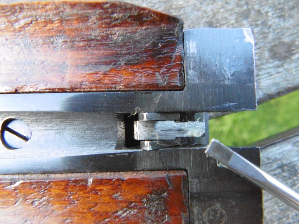

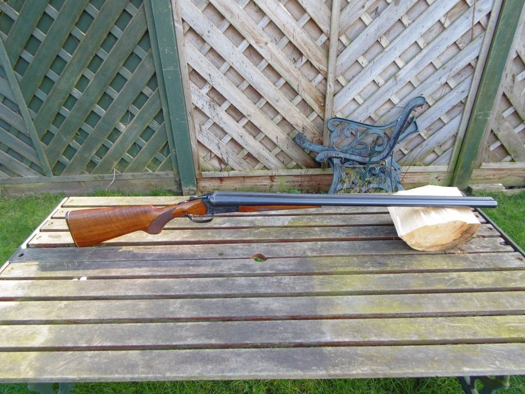

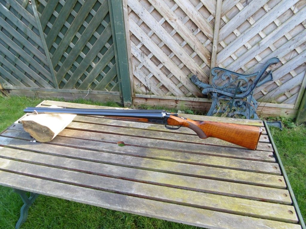

Overall in nice condition and just back in from a round of sporting. The central ejector spring either pings the left, right or both ejectors depending on the combination of barrel fired and the action of the trip/ release sears in the fore end. Shown with the tip of the screwdriver is the central selector 'switch' for changing between selective eject or extract, shown horizontal for extract.
Hi thanks for replies all
Not too sure on it's provenance and age.
I know Baikal's here in the UK have always been renowned for there no nonsense build quality, regarded as working tools for conditions in the field (and in England that usually means cold and wet :) )
Personally I've never known a marque whose barrel materials match up to the chrome bores of the Baikal, never known one to lead up or foul in the bores or forcing cones and this one is no different.
They are a ready to go unit whatever the weather, where as some of the more expensive 'toys' in the collection have never been out in the snow or rain or faced the rigours of being carried and bumped around when afield over ditches and fences and through the woods.
This one caught my eye as there is a good trace of figure to the woodwork and as mentioned some interesting 'engraving' ( very industrial, looks as though it has been milled in!) which adds to it's charm.
An honest tool, that's not too shabby to be in the company of far more expensive company, shoots to point of aim and if the recent round of sporting clays is anything to go by will add it's share of fur and feather to the 'pot' in my ownership
