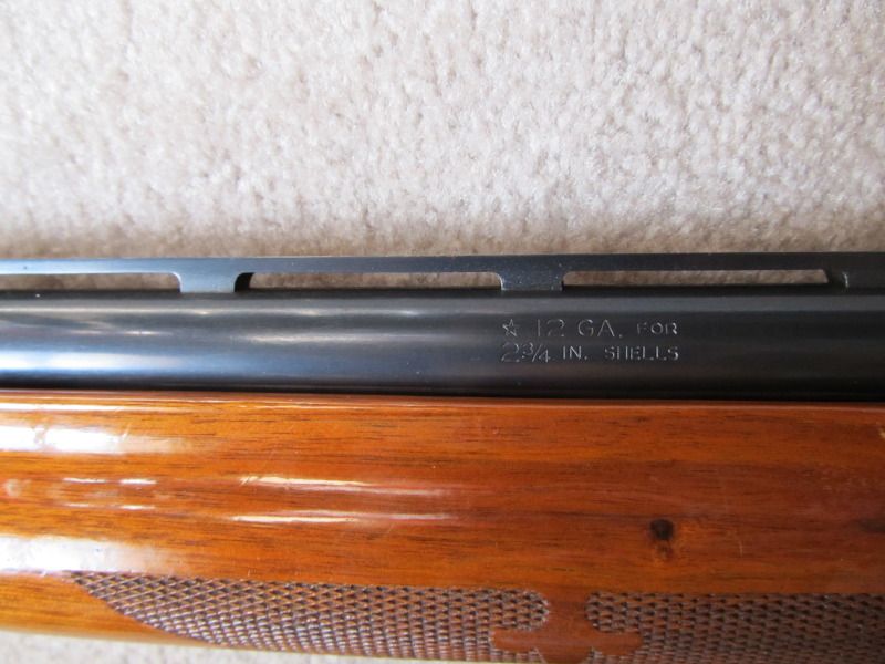

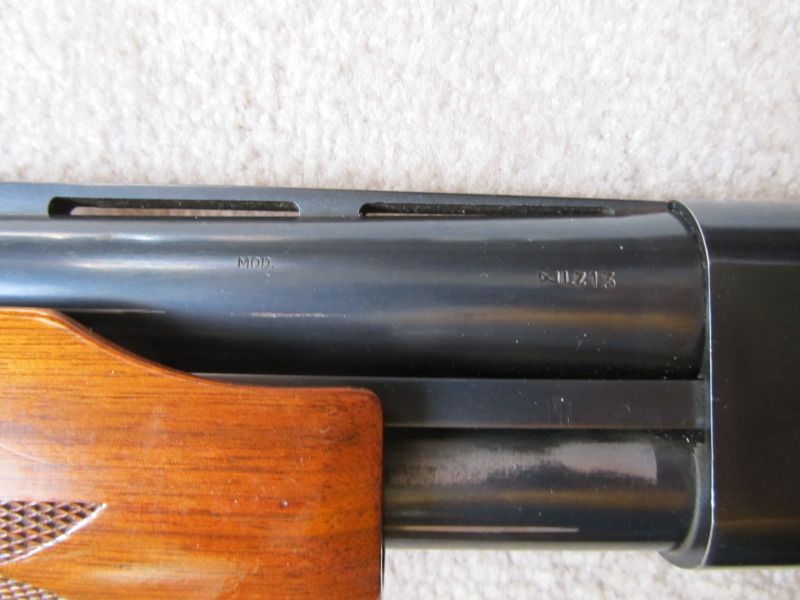

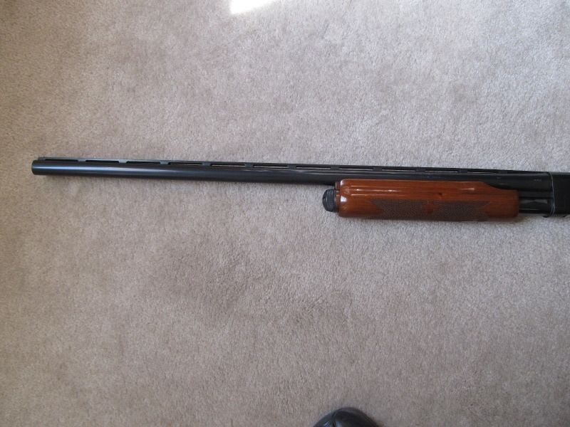

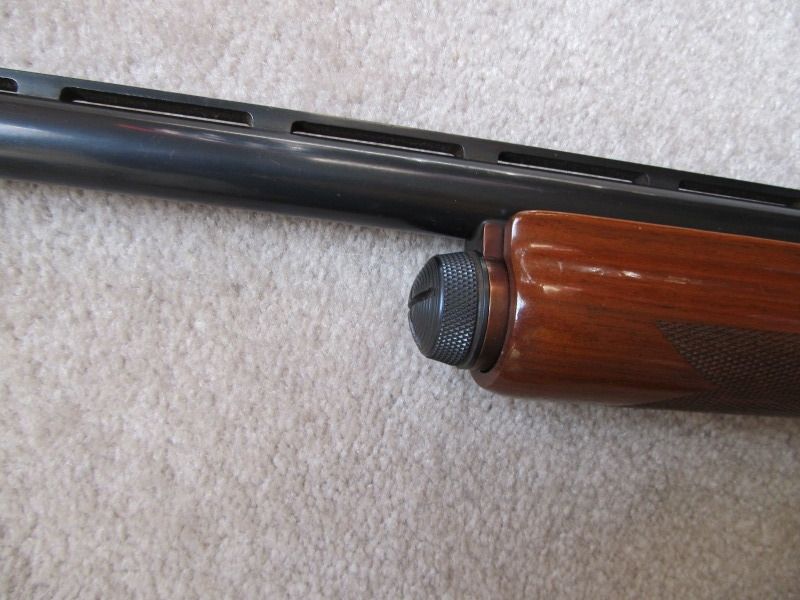

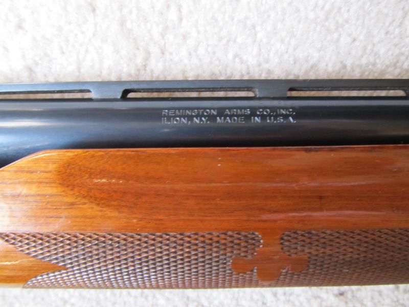

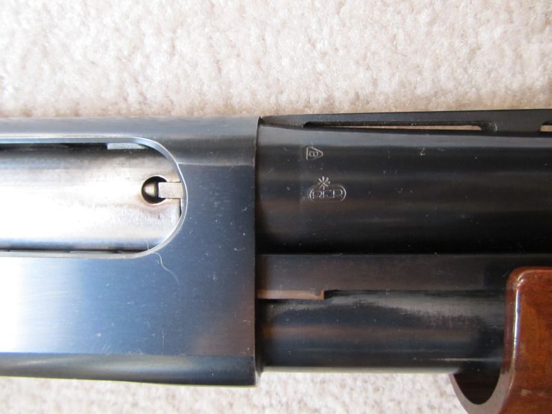

I just bought this gun for $300. According to the barrel marking it is either 1931, 1975, or 2005. Anyway I look at it, it sure is nice. I like the color of that whatchacallit.
It sure is smooth to operate. :D
The 870 Wingmaster was introduce in 1950, so your 1931 date is out....this leaves it as a 1975 version as it clearly is not a 2005 model.

Only shoot 2 3/4" shells in it as it is not a magnum and is NOT made to shoot 3" or 3 1/2" shells!
