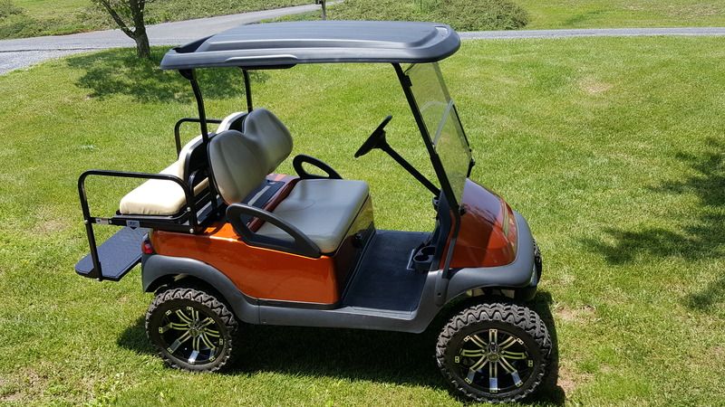

Finally picked up a cart yesterday. It is a 2012 club car 48v. I had them put all new Trojan batteries in it. It will run about 17mph on flat grond with 2 people in it. I have found some pretty steep hills to try it on (20 to 30 deg.). It slows it down some but I love how quiet it is. It does have LED lights. Guess I will see how she does.
#25 ·
I have an older aluminum frame club car. It is a 2000 year model. I worked with Buggies Unlimited to order a lift kit, wheels, 23 inch Swampfox tires, and a a high torque/ speed performance package. Then I added 48 volt Trojan batteries. It will run 32 mph on flat ground, and will accelerate strongly up steep grades. I can easily shoot a 3 day event without charging. It will probably make it through a 4 day shoot, but I have not had the courage to go that long without charging. I spent a total of $3k on parts plus $1700 on the used cart. I have been using it for 2 years with only one problem. The 600 amp controller that was included in the performance kit fried after 6 months. It was replaced on warranty. No problems since. I love zipping by the guys in their gas carts. You can modify gas or electric carts to do amazing things. I have seen gas carts with 13 hp Honda engines in them that are pretty strong and trouble free.
