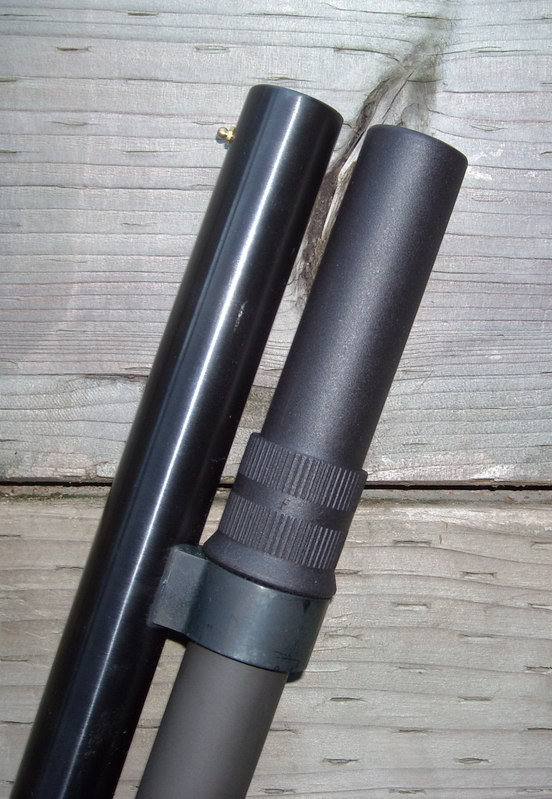

I have a 2 round extension on mine that goes flush to the end of the barrel. MAX100 on this sight makes them. Top notch. He will even make you one 1/10" shorter for use with a sling plate(so it still is flush to the end of the barrel).
MAX100 made me a magazine extension for my M-835 that has an 18.5" barrel. He does an outstanding job! The mag tubes are very well made and work great!
Here is pic of mine:
