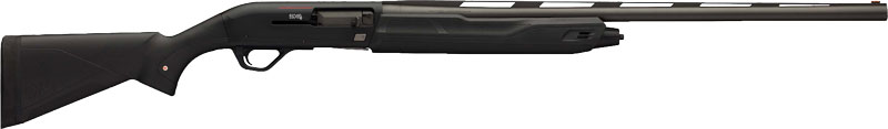

The Winchester SX4 comes in a compact size with barrel lengths of 24”, 26” and 28”.
It is a soft shooting gas type and is reasonably priced with great reviews and support.
The gas system is the same as the more expensive sister brand Browning uses.
It comes in 12 and 20 ga.
For Skeet I would go with a 20 ga. for her.
