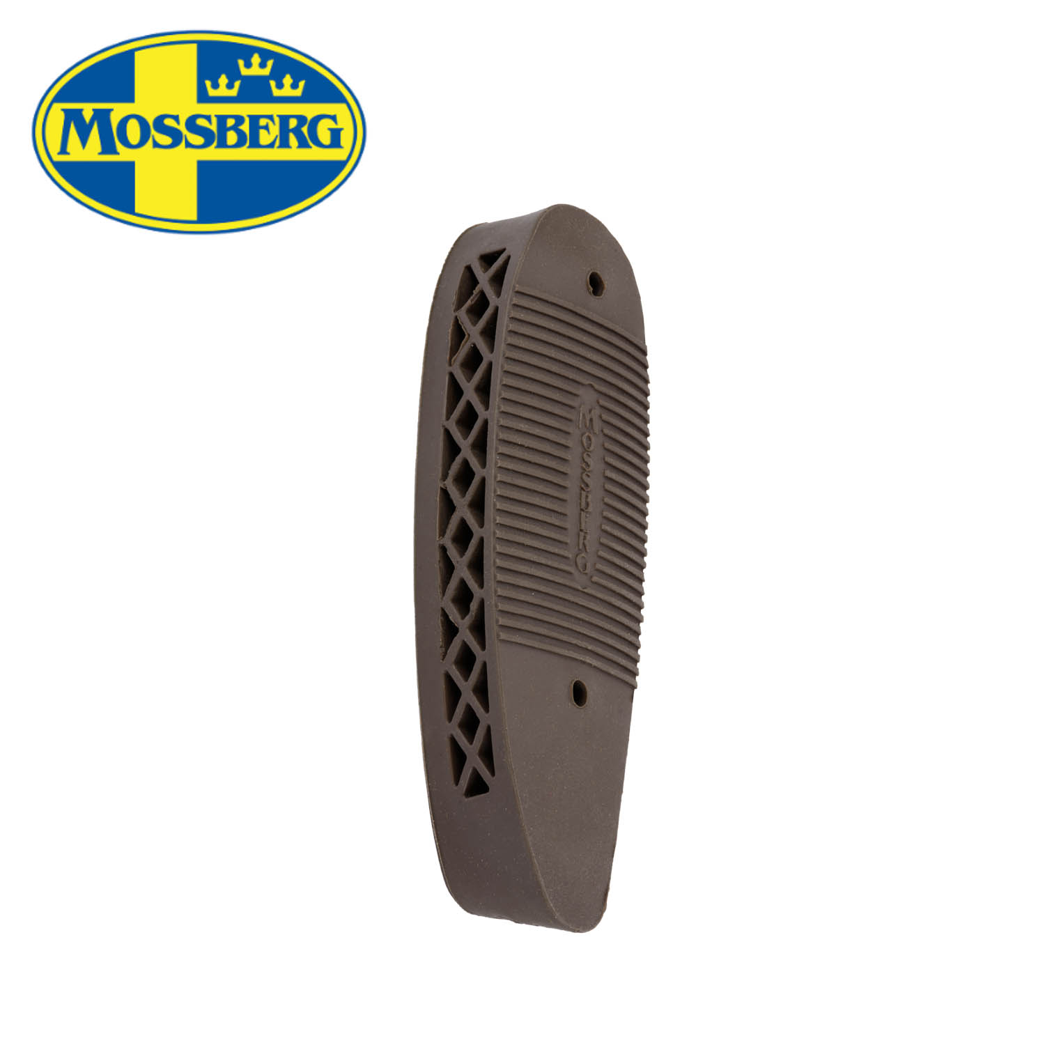

Have you tried calling Mossberg?
While this part is out of stock here it seems to indicate the 12 and 20 gauge use the same pad.
Which means there are probably several pre-fit pads that will work.
If you go to the limb saver website they have various templates of the pre-fit pads you can print on your home printer and compare the template to your original butt pad... Very easy to see if the 12 gauge pad will work.
