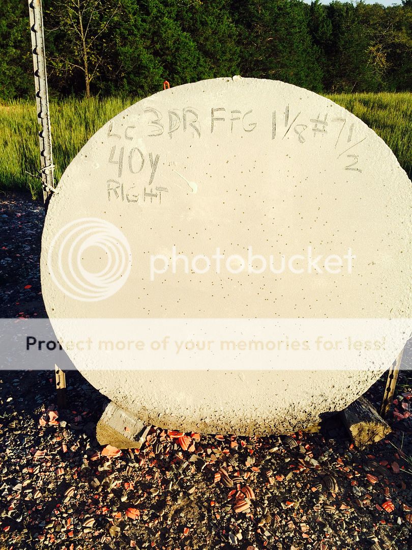

Now select a suitable old smoke pole like this 1902 O Grade Damascus a client actually gave me a few years ago in two pieces, but thanks to David Lauer and some artificial rawhide the broken stock is mended.
At forty yards the left full barrel shoots a good pattern with 3 drams FFG, 1 1/8 oz chilled 7 1/2 shot, Herter's hulls, 1/2 cushion and .125 nitro card. Didn't even have to change crimps from loading AA's on a MEC 600 Mk V with adjustable charge bar.
The right modified choke does open up just a bit.
It's for a crack shot at skeet though. Right and left barrels pattern tight at 21 yards.
