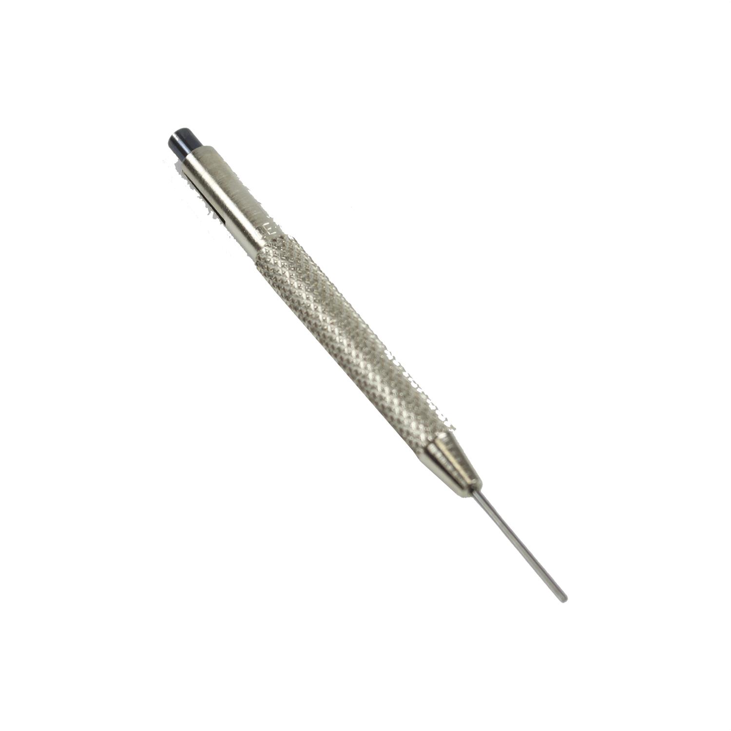

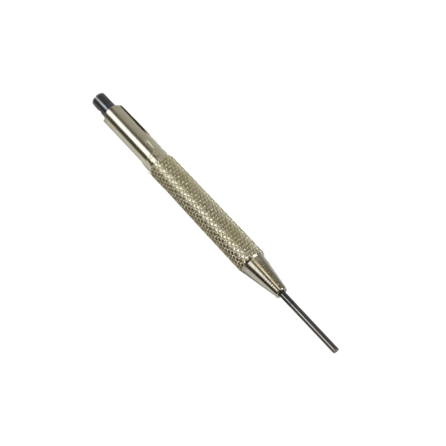

What is the process for swapping the hanger out? Was it pretty easy?
Easy on a K80 if you have the right punches. I'd recommend buying a set of these:
And a few extra roll pins if you don't have them: Hanger Roll Pin | Krieghoff
Without the right size punches it can be challenging...............I speak from experience. 😕 With the punches it is a piece of cake. Here is the video:
