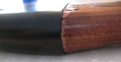

The front re-profile came out pretty well...
...even though the metal stood a little proud:

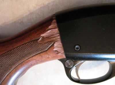

Now the problem arose because I relieved the bearing surface 1/32" or so to acomodate the stock bearing plate I had on order (it arrives today). Unfortunately, I was impaitient, forgot about the plate, and test-fired the gun on Sunday. {F*

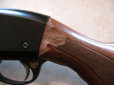

Here's what the stock looks like now:
The splinters were unrecoverable, but the stock functions fine as is (no cracks or splits).
My question is, is there ANY way I can salvage the aesthetics of this stock, or am I just SOL, and need to replace it? The whole stock refinished quite nicely, and the rest of the stock is still gorgeous.
I'd hate to think I completely trashed the stock by my own impatience. :(
You can reattach the peices that you managed to recover and fill the gaps with Acraglas tinted to match the color of the wood.
BUT, to quote a line I really liked....it's going top look like frozen peanut butter.
I dont think Goldilocks will be impressed.
Buy a new stock and do it right. In addition as your not experienced with fitting a stock with perfect tolerances I'd order Acraglas and glass bed the head into the receiver. Done right it will be invisible and will insure 100% even contact between wood and metal helping to prevent cracks down the road.

I think the idea of shortening it from the front was to bring the pistol grip closer to the trigger? and slim up the area of the hand. Sure, you could fill it in with acura glass, the scraps you have, and some sawdust.
But I like the idea of ordering a roughed out stock from somebody like Macon stocks and restocking it for her.

I would be tempted to clean up the top and live with it. I would look hard at cutting down the sides of the stock to a depth to clean up the mess, then cut and glue in some pieces of walnut and reshape the head of the stock. That might turn out looking a little nicer than frozen peanut butter.
Dave
Funny enough...
I picked up the chunk of walnut I hacked off to shorten the LOP, and was considering doing exactly that. A sort of veneer job with the scrap I already have from the same piece of wood.

Update: Here's the process in pretty (ugly) pictures:
Cutting/carving out the chipped areas on the head of the stock:
Templates made, and transferred to the scrap left over from shortening everything up:
Left/right inserts cut and applied to the stock head:
Unfortunately, after six+ hours of shaping, the inserts were not enough. There would have been significant gaps at the sides (the inserts weren't tall enough - they just might have fit inside the receiver).
I informed the wife that I was beaten, and dejected; added a synthetic stock to my shopping cart at Brownell's. Just before hitting "submit", I did a quick sweep of the classifieds here at SGW, hoping beyond hope for a cheap Wingmaster stock. I found a used 870P stock (no checkering), and was about to drop the guy an email when I began to think about what it was that I would want to do with the stock.
After a moment's pause, I said to myself "Hmmm, you could just cut the head off that stock and epoxy it on to the one you have now.".
After another moment's pause, I said to myself "FMD, what the devil did you do with that beat-up 870 Express stock you've been screwing around with?".
Here's a visual of what was going through my head&#8230;
&#8230;and that thought played out:
Now while playing with adapting an 870 synthetic stock to this gun, I had discovered that the action spring tube had a beautiful fit inside a length of ½" i.d. copper tubing (don't bother asking why I figured it out, just realize that in a moment of desperation, I did). So to align both pieces of wood to the action spring tube (required for proper operation), I bored out a section of each to 5/8" (which is the o.d. of the half-inch copper tube), inserted the tubing, and here's how things lined up:
There were certainly some odd discrepancies between the two pieces&#8230;
&#8230;but nothing that a little shaping couldn't fix:
The joint itself was epoxied together over the copper tube, and with a small section of brass rod inserted into both pieces.
I knew going in that I would lose the checkering, but the tradeoff of having a majority of he original stock present was worth it to the wife. The fit worked out fairly well in the end:
Getting the crap Express wood to match the beautiful Walnut was a different story, and a process I'd rather not repeat. In the end, a 3-to-4 mixture of Minwax RedOak to Minwax Heritage worked about as well as can be expected under the circumstances*:
The following are photos taken while trying to highlight the mismatch:
In all actuality and in person, the difference seems closer to this photo:
*Hindsight is 20/20. If I had to do it all over again, I would have stained the entire piece, or at least blended the stain over top of the joint and into the old stock. As it stands, the original stock is "naked" and unstained, while the Express piece has been worked extensively on its own in an attempt to match the natural color of the original wood.
The last photos show things how they stand: Two coats of Minwax Satin Spar Urethane on top of naked/stained wood with a few coats of wetsanded Tru-Oil to fill in the grain. I have yet to do final fitting and bedding of the stock to the action, but I needed to take a bit of a break from this monster.
All-in-all, it's not a seamless repair or a perfect match, but it's a solid assembly, the angles fit Goldilocks :wink: , and from 6' away, you can't really tell that any re-work has been done.
